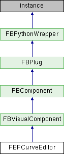

#include <mobu-python-api.h>
FCurve editor.
