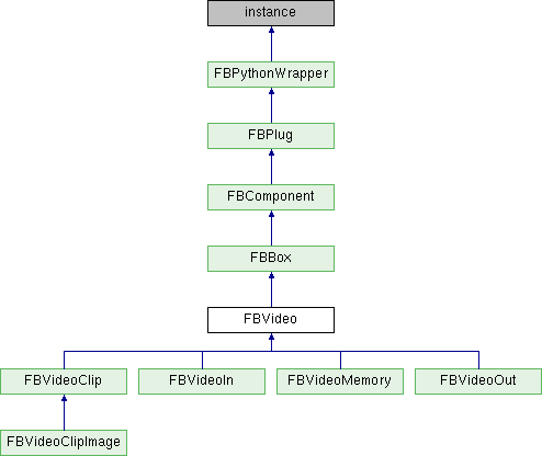

Video media class.
Similar to the FBModel class, the FBVideo class serves as a general media class for images, video clips and video memory, as well as the possibility of custom formats and custom live cards.
Inheritance diagram for FBVideo:Public Member Functions | |
