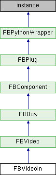

FBVideoIn Class Reference
#include <mobu-python-api.h>
Class Description
Basic video input class, supporting webcam and DV device.
+ Inheritance diagram for FBVideoIn:
