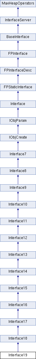

Extends Interface18 Client code should retrieve this interface using GetCOREInterface19.
Inheritance diagram for Interface19:Public Member Functions | |
