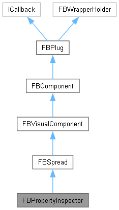

Inheritance diagram for FBPropertyInspector:
