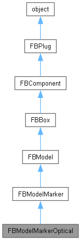

Optical model marker class. More...
#include <pyfbsdk_generated.h>

Public Member Functions inherited from FBModelMarker | |
| FBModelMarker (str pName) | |
| Constructor. | |
Public Member Functions inherited from FBModel | |
| FBModel (str pName) | |
