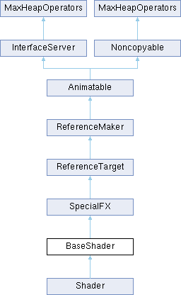

BaseShader Class Referenceabstract
One of the base classes for the creation of the Shaders, which plug-in to the Standard material[? More...
#include <C:/adskgit/3dsmax/3dsmax/3dswin/src/maxsdk/include/shaders.h>
Inheritance diagram for BaseShader:
