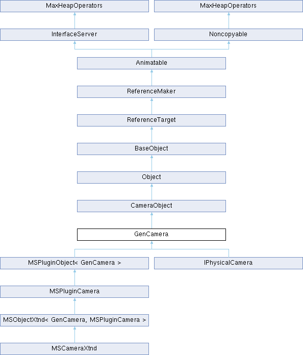

GenCamera Class Referenceabstract
#include <C:/adskgit/3dsmax/3dsmax/3dswin/src/maxsdk/include/gencam.h>
Inheritance diagram for GenCamera:

See also
Class CameraObject, Class Interval, Class Control.
Description:
This class describes a generic camera object. It is used as a base class for creating plug-in cameras. Methods of this class are used to get and set properties of the camera. All methods of this class are virtual.
Member Function Documentation
