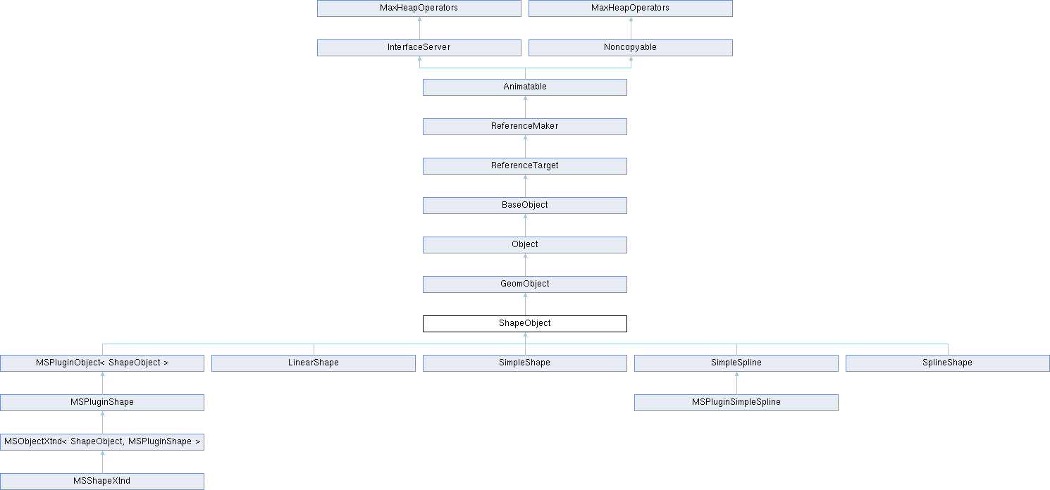

ShapeObject Class Referenceabstract
ShapeObjects are open or closed hierarchical shapes made up of one or more pieces. More...
#include <C:/adskgit/3dsmax/3dsmax/3dswin/src/maxsdk/include/object.h>
Inheritance diagram for ShapeObject:
