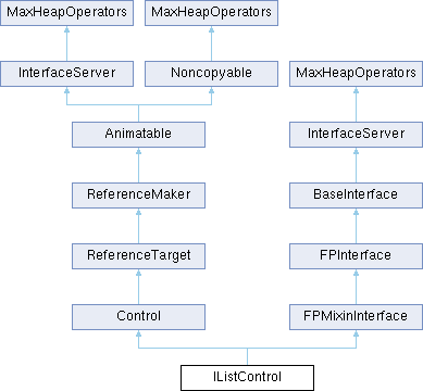

Inheritance diagram for IListControl:

Detailed Description
IListControl provides API access to list control functionality.
The interface is returned by calling GetIListControlInterface.
See also
Class Control, Class FPMixinInterface
Description:
This class represents the interface to the list controller. You can obtain a pointer to the list control interface using; GetIListControlInterface(cd). This macro will return (IListControl*)(CD)->GetFPInterface(LIST_CONTROLLER_INTERFACE).
The Class ID's of individual controllers are; FLOATLIST_CONTROL_CLASS_ID, POINT3LIST_CONTROL_CLASS_ID, POSLIST_CONTROL_CLASS_ID, ROTLIST_CONTROL_CLASS_ID, SCALELIST_CONTROL_CLASS_ID, DUMMY_CONTROL_CLASS_ID, DRIVERBLOCKLIST_CONTROL_CLASS_ID, TMLIST_CONTROL_CLASS_ID.
All methods of this class are Implemented by the System.
