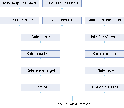

ILookAtConstRotation Class Referenceabstract
#include <C:/adskgit/3dsmax/3dsmax/3dswin/src/maxsdk/include/istdplug.h>
Inheritance diagram for ILookAtConstRotation:
