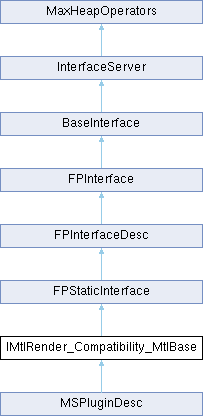

IMtlRender_Compatibility_MtlBase Class Referenceabstract
#include <C:/adskgit/3dsmax/3dsmax/3dswin/src/maxsdk/include/IMtlRender_Compatibility.h>
Inheritance diagram for IMtlRender_Compatibility_MtlBase:

To be inherited by a ClassDesc or ClassDesc2 of a Texmap or Mtl plugin. The child class needs to call Init(*this) in its constructor.
