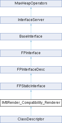

Inheritance diagram for IMtlRender_Compatibility_Renderer:
