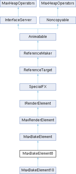

3ds Max C++ API Reference
Extention to MaxBakeElement in 3ds Max 8. More...
#include <C:/adskgit/3dsmax/3dsmax/3dswin/src/maxsdk/include/renderelements.h>
Extends MaxBakeElement, allowing Texture Bake Elements to provide parameters of integer, float, and color types in addition to booleans. The RTT dialog is updated to display spinners and color swatches accordingly
