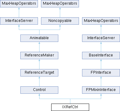

Inheritance diagram for IXRefCtrl:

This method overrides GetID() in those interfaces that do not publish metadata but instead have a unique Interface_ID for quick internal identification in implementation code that might be shared by a bunch of mixin interfaces.
Returns
The Interface_ID.
Default Implementation:
{ return GetDesc()->ID; }
Reimplemented from FPMixinInterface.
65{return IID_XREF_CTRL;}
◆ GetDesc()
virtual FPInterfaceDesc * GetDesc ( )
inlinevirtual
Remarks
Returns a pointer to the class which contains the interface metadata.
Implements FPInterface.
66{return GetIXRefCtrlDesc();}
virtual FPInterfaceDesc * GetIXRefCtrlDesc()=0
Returns the function publishing descriptor for the XRef Controller.
◆ FN_1()
◆ VFN_0()
◆ GetInterface() [2/2]
virtual BaseInterface * GetInterface ( Interface_ID id)
inlinevirtual
Inherited from Animatable.
Returns a pointer to the Base Interface for the interface ID passed.
Parameters
id- The unique ID of the interface to get
Returns
A Pointer to the Interface
Reimplemented from Control.
601{ if (id == FPMIXININTERFACE_ID) return this; else return FPInterface::GetInterface(id); }
virtual BaseInterface * GetInterface(Interface_ID id)
Definition ifnpub.h:146
#define FPMIXININTERFACE_ID
Definition ifnpub.h:61
