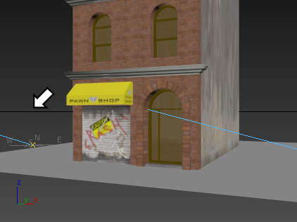

- Show Horizon Line
- When on, the horizon is displayed as a horizontal line in camera viewports (assuming the camera frame includes the horizon). Default=off.
Horizon line in a Physical Camera viewport
