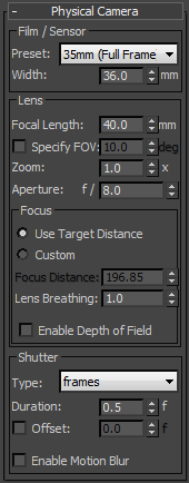

Sets the camera's main physical attributes
Film / Sensor group
- Preset
- Chooses the model of film or charge-coupled sensor. The choices are 35mm (Full Frame) film (the default), and a variety of industry-standard sensor settings. Each setting has its default Width value. The Custom choice is for choosing an arbitrary Width.

- Lets you manually adjust the width of the frame.
Lens group
- Focal Length
- Sets the focal length of the lens. Default=40.0mm.

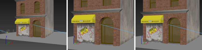

- Specify FOV
- When on, lets you set a new Field-of-View (FOV) value, in degrees. The default FOV value depends on the Film/Sensor Preset you have chosen. Default=off.
Changing the FOV too drastically can cause perspective distortion.
Note: While Specify FOV is on, the Focal Length control is disabled. However, changing the value of one of these controls also changes the value of the other. - Zoom

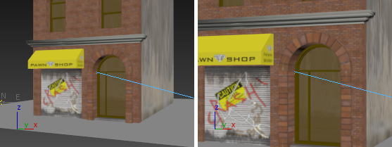

- Zooms the lens in or out without changing the camera position.
Zoom provides a way to crop the rendered image without altering any other camera effects. For example, changing the Focal Length changes the bokeh affect (because it changes the aperture size), while changing the Zoom value does not.

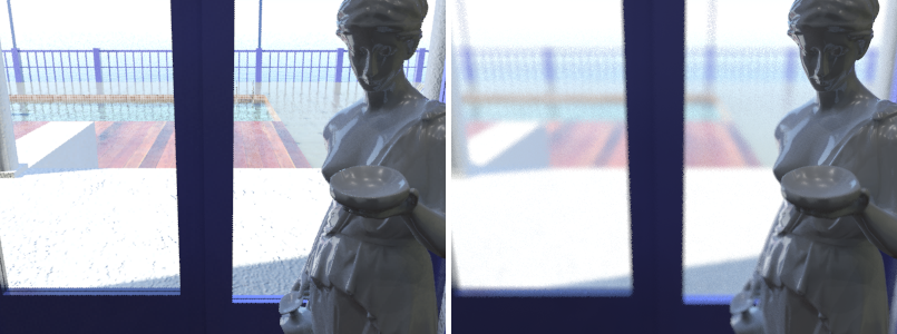

Enable Depth of Field When on, the camera generates blurring at distances not equal to the focus distance. The strength of the depth-of-field effect is based on the Aperture setting. Default=off.
Left: No depth of field
Right: Shallow depth of field (Aperture = f/1.4)

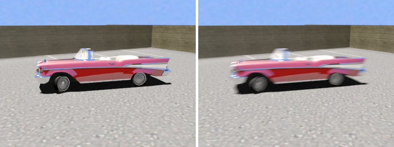

- Enable Motion Blur
- When on, the camera generates motion blur. Default=off.
Left: No motion blur
Right: Default motion blur (Duration = 0.5 frame)
