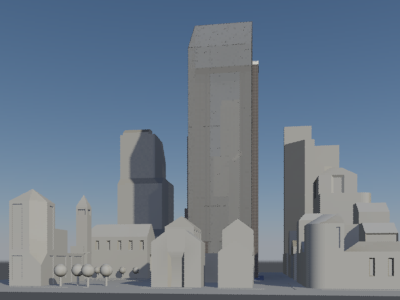

Adjusts the perspective of the camera view.
Lens Shift group
These settings shift the camera view horizontally or vertically without rotating or tilting the camera. In both the X and Y axes, they are expressed as a percentage of the film/frame width (disregarding the image aspect ratio).

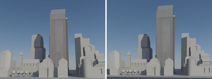

Tilt Correction group
These settings tilt the camera horizontally or vertically. You can use them to correct the perspective, particularly in scenes where the camera is already tilting up or down.
Left: No correction; Right: Vertical correction = 0.3
- Auto Vertical Tilt Correction
- When on, sets the Tilt Correction
Vertical value to align perspective along the Z axis. Default=off.
Auto Vertical tilt correction
