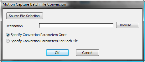

Converts one or more CSM or BVH motion-capture files to filtered BIP format.
Interface
- Source File Selection
Opens a dialog where you can specify motion-capture files to convert. Use Shift+click to select all contiguous files between the two that you click. Use Ctrl+click to add individual files to the selection.
- Destination Directory
Specifies the directory in which to store the filtered files.
- Specify Conversion Parameters ...
Lets you choose how to specify conversion parameters:
- Specify Conversion Parameters Once Imported files use a single set of conversion parameters.
- Specify Parameters For Each File You specify conversion parameters for each file.
