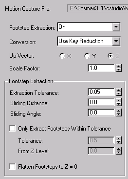

- Motion Capture File
- Displays the file to be imported.
- Footstep Extraction
- Motion-capture data can be applied to the biped in one of three ways:
- None: Freeform No footsteps are extracted.
For swimming or flying motion data, footstep extraction is not necessary. For a traditional approach to character keyframing, use this option to keyframe the biped without footsteps or Biped Dynamics; this is essentially a freeform animation.
- On Extracts footsteps.
Direction and style of the motion-capture data are easily edited.
Allows changes to the toe structure of the biped after import; footsteps will readjust the character’s motion to maintain correct foot-toe-ground contact at all times, a common problem associated with motion-capture import.
Inappropriate “sliding feet” in the motion data are corrected.
- Fit to Existing Fits to existing footsteps.
Use with motion data that has both footstep motion and flying, swimming, falling, or tumbling motions.
First load the motion data using Perform Footstep Extraction. Create a freeform period for the flying, swimming, or falling portion of the data in Track View, and then reload the same motion capture file using the Fit to Existing option. The freeform area is loaded with data from the motion capture file without the influence of biped dynamics.
- Conversion
- Chooses the type of key processing.
- Use Key Reduction Reduces keys for simpler key editing.
- No Key Reduction Does not reduce keys. Use this on files that are already key reduced or if you want to work with all the data in a raw motion-capture file. Note: Marker files imported for the first time should be loaded with no key reduction or footstep extraction to enable the calibration controls on the Motion Capture rollout.
- Load Buffer Only Does not apply the data to the biped, but loads the data to the motion-capture buffer only. Use this either to compare your edited version with the original or to paste postures from the motion-capture buffer to the biped in the scene. Tip: To compare the filtered data with raw motion-capture data, use Show Buffer on the Motion Capture rollout rather than turning off key reduction.
- Up Vector
- Sets the vertical axis used in the motion-capture data.
- Scale Factor
- Multiplies the stored talent size by this value and size the biped accordingly.
Footstep Extraction group
Options here are active when Footstep Extraction is on.
- Extraction Tolerance
- Sets the sensitivity of footstep extraction. character studio determines if the footstep is there by checking that the foot does not move beyond the distance determined by the Extraction Tolerance value. Smaller numbers are more sensitive and extract more footsteps. The value is a percentage of foot length.
The default value is 0.15. Increase this value to 0.2 or 0.25 if too many footsteps are generated.
- Sliding Distance
- Creates a sliding footstep when positional tolerance is reached. This value is a percentage of foot length. By default, the foot must slide its own distance (100), before a sliding footstep is created.
Use this with motion-capture files that contain sliding feet. A sliding footstep can be created manually by setting IK Blend
0 for a biped foot at a "touch" state key (biped foot first touches a footstep). Note: Sliding footsteps display as a footstep with a line through the center. - Sliding Angle
- Creates a sliding footstep when rotational tolerance is reached. This value is in degrees; the default is set high (360 degrees). The foot must make a complete turn before a sliding footstep is created.
Use this with motion-capture files that contain feet that pivot, as in a dance motion.
Note: Sliding footsteps display as a footstep with a line through the center. - Only Extract Footsteps Within Tolerance
- Turns on Z -axis Tolerance. These controls filter out footsteps that do not fall within a given range of the ground plane. Use this when filtering motions, such as hopping or pitching a baseball, in which a foot might come off the ground and remain stationary, but its position is not intended as a footstep.
- Tolerance Value is a percentage of leg length.
- From Z Level Set a Z value (ground).
- Flatten Footsteps to Z=0
- Moves extracted footsteps to Z=0. Use this to flatten out minor differences in the height of the extracted footsteps.
Load Frames group
- Start
- Start importing at this frame. Default is frame 0, the first frame.
- End
- Stop importing at this frame. Default is the last frame of the clip.
- Loop
- Loop the data by the value set here.
This is relative. Succeeding loops start where the previous loop left off. The clips are not blended and may require editing unless the original clip was designed to loop.
Use this for clips designed to loop.
Note: This often works best if Footstep Extraction is tuned off.

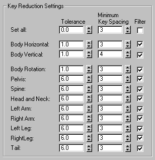

Key Reduction Settings group
Key reduction keeps the original motion intact and intelligently filters out more than 80 percent of the keys in the motion-capture file, making the process of altering the biped animation much simpler.
Use the Tolerance and Minimum Key Spacing settings to fine-tune key reduction for a specific track (body part). Specify whether or not to filter a track in the Filter column.
These settings are available only if Conversion is set to Use Key Reduction.
- Tolerance
- Sets the maximum angular or positional deviation for a track.
Values are in units of translation for position tracks, and in degrees for rotation tracks.
- Minimum Key Spacing
- Sets the minimum number of frames between keys.
Tolerance is computed first, then Minimum Key Spacing computes further key reduction.
A Minimum Key Spacing value of 10 for the head track ensures that no two keys are closer than 10 frames for this track.
- Filter
- Turn off to prevent filtering of the motion capture data into a track. When this is off, there is no key reduction for the track.
- Set All
- Forces all tracks to the values set in these fields.
Higher values here can determine how much key reduction is possible while preserving the original motion.
