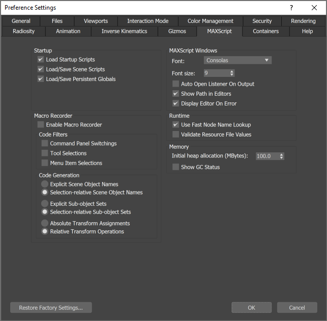

MAXScript Preferences
On the MAXScript panel of the Preference Settings dialog, you set MAXScript and Macro Recorder preferences, enable or disable auto-loading of scripts, set the initial heap size, change font style and size used in the MAXScript editor, and manage all the settings for the Macro Recorder.

Interface
Startup group
You can load scripts automatically in two ways. You can create a file named startup.ms that contains your startup code. MAXScript searches for this file in these locations in this order: the user scripts directory, the user startup scripts directory, the 3ds Max system scripts directory, and the 3ds Max system startup scripts directory. MAXScript stops searching after it finds the first occurrence of startup.ms.
You can also place the script files you want auto-loaded into the \startup directory inside the user startup scripts. MAXScript loads any script file with the file name extensions .ms, .mcr, .mse, and .mzp. If you want a script to be ignored on startup, you can give it the .mxs extension, which is not loaded on startup but recognized as an executable script by the MAXScript Editor.
If you have both a startup.ms file and auto-load files in the \startup directory, MAXScript always loads startup.ms first.
Load Startup Scripts
Loads scripts automatically when 3ds Max starts.

MAXScript Windows group
Font drop-down list
Choose a font for the MAXScript editor

Auto Open Listener On Output
Opens the Listener if a script sends output to a WindowStream value with no associated window. This would require a MAXScript extension.
Show Path in Editors
When on and editing a script, the script window title bar shows the file name and entire file path. When off, the title bar shows the script file name only.
Display Editor On Error
When on, the MAXScript Editor displays when a running script encounters an error. When off, errors are displayed in the mini-listener only. Turning this setting off can be useful when running scripts from an external editor.
Runtime group
Use Fast Node Name Lookup
When on, MAXScript indexes scene node names in a cache, resulting in significantly faster resolution of non-wildcard pathname values (for example, $box01) to node values. When off, the scene nodes are enumerated as MAXScript looks for a scene node name that matches the pathname, resulting in slower lookups.

Memory group
Initial Heap Allocation (Mbytes)
Sets the initial heap allocation.
MAXScript carves its own working memory (called a heap) out of the memory that 3ds Max allocates. You can add to the heap at any time by increasing the value here.
Macro Recorder
Controls in this large group are for recording macros. See Macro Recorder.
Enable Macro Recorder
Enables the Macro Recorder.
3ds Max starts with the macro recorder disabled and a minimized Macro-Recorder pane in the MAXScript listener window.
You can also enable the Macro Recorder by turning on MAXScript Macro Recorder or by turning on Enable in the Macro Recorder menu on the MAXScript Listener toolbar.
This state is stored in the 3dsmax.ini file. Turning it on once keeps it enabled across restarts of 3ds Max.
