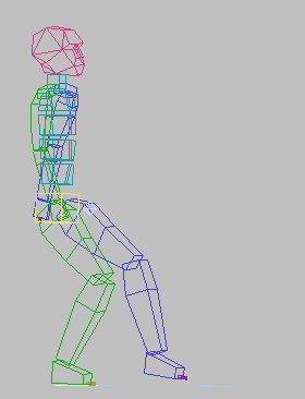

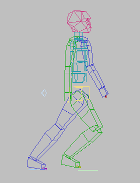

- Characters that are pushing or pulling objects might need their center of mass moved slightly behind the pelvis. Note: If you place the center of mass too far in front of the pelvis, the character unnaturally compensates for balance. As each step is taken, the legs and body move in an awkward fashion, as if there was an invisible weight attached to the front of the character.
Center of mass moved behind the biped in rubber-band mode
Center of mass moved in front of the biped in rubber-band mode

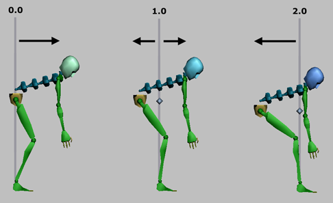

Balance Factor
The balance factor is an animatable parameter that determines how the biped's hips and spine will compensate when the biped bends forward or backward.
The balance factor determines the degree and direction in which the head and/or hips swing out from their original vertical alignments when the biped bends over.
Results when balance factor is set to 0.0, 1.0 and 2.0 before the spine is animated to make the biped bend over.
The Balance Factor parameter can have any value from 0 to 2:
- When Balance Factor is 1 (the default value) and you rotate the spine forward, both the hips and head swing out from their original vertical alignment to a similar degree to compensate for the shift in weight. This value is suitable for times when the biped leans forward while standing.
- When Balance Factor is 0 and you rotate the spine forward, the COM keeps its original vertical alignment, and the head swings forward. There is no movement in the hips to compensate for the shift in body weight. This setting is good for animating a sitting biped who leans forward, to prevent its hips from shifting backward. It can also work well for characters with tails; the tail provides weight in back of the biped, so the hips don't have to shift backward to compensate when the character bends over.
- When Balance Factor is 2 and you rotate the spine forward, the head retains its original vertical alignment while the COM swings backward. The hips compensate strongly for the shift in body weight. This setting can be useful for violent or acrobatic motions.
In order to affect the animation, the balance factor must be set before you animate the biped. The balance factor can be animated to give the biped different reactions to bending motions over the course of the animation.
