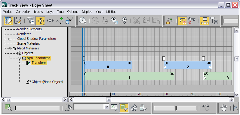

Footstep keys have their own display in Track View's Dope Sheet mode. Footstep keys are displayed as blocks of color, each indicating a period of time when one of the biped's feet is in a footstep.
Footsteps in Track View
The footstep key colors match the colors of footstep icons in viewports. Just as with footstep icons, inactive footsteps are brightly colored, while active footsteps are displayed with pale colors.
The footstep key display relates directly to the different states the leg and foot can be in at any given time. The left edge of each footstep key indicates the foot is in the Touch state, while the right edge indicates the Lift state. The duration of the footstep key between Touch and Lift indicates the time the foot is in the Plant state. The space between footstep keys indicates a time when the foot is completely out of a footstep, a Move state.

Selecting footsteps also selects the footsteps in Track View. A selected footstep in Track View has a white border and a dot on both the left and right edges of the footstep key.
Footstep key selected in Track View
