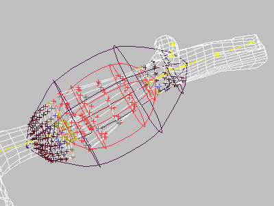

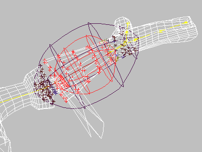

You'll note problems with vertices as you preview motion. It sometimes looks like vertices got left behind when the link they were supposed to be attached to moves in 3D space. In fact, that's just what is happening: they weren't assigned to any link at all, and remain where they were at the initial skeletal pose: the pose of the mesh and its skeleton at the time Physique was applied and initialized.
The other case would be vertices being moved too much, resulting in a dent in the mesh. You'd fix this by decreasing the overlap of the envelopes affecting a joint.
Stray vertices (above) reassigned to correct link(s) by modifying envelope shape (below).

  1. In the Blending Envelopes rollout Selection Level group, activate (Link). In a viewport, pick any link.
  2. In the Parameters group, turn on the Inner, Outer or Both option and then increase the value of Radial Scale until the outer envelope just surrounds the character mesh.
    Note: With Both turned on, both the inner and outer bounds scale together.
  3. Increase the Parent Overlap value until the inner (red) envelope appears through the mesh.
  4. If necessary, decrease the Falloff value to strengthen this envelope.
