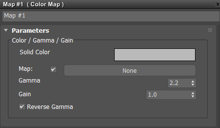

Procedure
To color a map:
- In the Color Map Parameters rollout, click the Map button marked None.
The Material/Map Browser opens.
- Select the map you want to colour.
Note: Alternatively, you can use the Slate Material Editor to wire a map to the ColorMap component.
- Click the Solid Color swatch.
The Color Selector dialog opens.
- Choose a new color.
- Set the Gamma and Gain values.
- Select Reverse Gamma if required.
Interface
Color/Gamma/Gain group
- Solid color
- Opens the Color Selector: Solid Color dialog, where you can select the color using RGBA values, HSV values, or by clicking on the desired color.
- Map checkbox
- Toggles the effect of the map.
- Map button (None)
- Opens the Material/Map Browser.
- Gamma
- The gamma value applied to the input.
- Gain
- The multiplier for the input.
- Reverse Gamma
- When off, the map multiplies the input by the gain value, and then applies a gamma correction to the color. When on, the map applies a reverse gamma correction to the color and then divides it by the gain.
