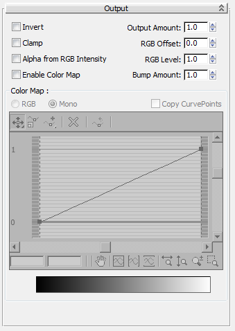

Output rollout
The controls in this rollout are the same as for maps with a built-in output option. See Output Rollout.
