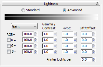

Lightness rollout: Advanced
The Advanced controls are similar to those available in the Photo Lab feature of Autodesk Toxik. This tool lets you simulate camera exposure and photo-development changes in maps. You can change the exposure to brighten or darken a map in incremental steps,providing perceptually relative uniform changes in luminance. Photo-development adjustments can produce images with different color distribution.
- [exposure method]
Choose from the drop-down list the method by which to express exposure:
- Gain The pixel color values are multiplied by this value.
- F-Stop As in photography, increasing by 1 doubles the luminance, and increases gain by a factor of 2.
- Printer Lights A definable setting (see Printer Lights per Stop) where increasing this value by the value of the Printer Lights per Stop setting (N) doubles the luminance (N printer lights=1 f-stop)
- RGB/R/G/B
You can change the settings for all three color channels simultaneously (RGB) and for each channel individually. In addition, you can toggle the settings for the individual channels with the checkboxes.
- Gamma/Contrast
The amount of gamma correction can be expressed in terms of contrast or in terms of the usual gamma exponent. Increasing the gamma exponent decreases contrast.
- Pivot
Gamma correction is applied about a pivot value. That is, pixel values equal to the pivot value are left unchanged. This is useful when you want to use gamma correction to change the contrast of an map but do not want to affect a particular luminance level.
- Lift/Offset
The lift is simply a uniform offset added to all the pixel values (different offsets for different color components). Lift is usually applied as the last step of the process and can be used to control the overall brightness of the map.
- Printer Lights per Stop
When using the Printer Lights exposure method, this setting determines the number of printer lights equivalent to one f-stop; that is, the number required to double or halve the exposure.
