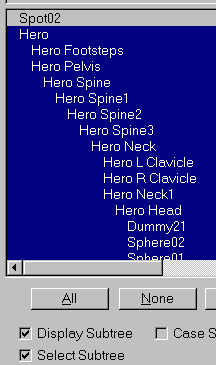

- In the Merge dialog, click to turn on Select Subtree.
- Locate and click the biped's center of mass name in the Merge dialog list.
The default name for the biped center of mass is Bip001. If the biped was renamed on the Structure rollout, find the renamed center of mass in the list.
Note: The center of mass is the root object in the biped hierarchy, if this is selected with Select Subtree turned on, then all the child links are selected, including extra bones and the mesh skin (the mesh skin is linked when Attach To Node is used in Physique).
Selecting a biped while merging a MAX scene
In the illustration, the center of mass object is named Hero . With Select Subtree active, all the children are also selected when you click Hero, including the Physique mesh.
