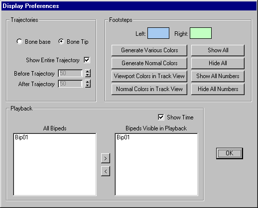

The Display Preferences dialog lets you customize how bipeds are displayed while you work with them. This topic introduces some of the commonly used options.
Use controls on this dialog to change footstep, trajectory, and playback display.
In the Trajectories group, you can choose between the Bone Base or Bone tip for trajectory display. You can show the entire trajectory, or define a range of frames for partial trajectory display.
In the Footsteps group, you can choose colors for the left and right footsteps, and generate various colors or standard colors in the viewport or Track View. You can also Show or Hide All Footsteps or Footstep Numbers.
In the Playback group, you can define which bipeds will appear in Biped Playback. (This can be useful for speeding performance if your scene contains a number of bipeds.)
