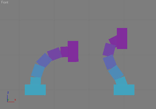

A Relative spine produces a smooth C-shaped curve, while an Absolute spine creates an S-shaped curve.
Left: Relative spine
Right: Absolute spine

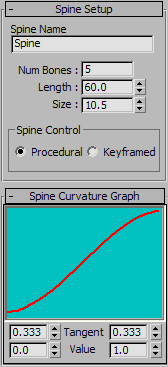

Spine Curvature Graph rollout
The Spine Curvature rollout settings control the extent to which spine links rotate relative to each other. In other words, it controls how the rotation between the hubs is distributed along the spine.
You edit the spline by adjusting the Tangent and Value settings at the bottom of the rollout.
Tangent
The Tangent settings control the shape of the curve at its left and right ends, respectively.
Value
The Value settings control the start and end values of the rotation weights.

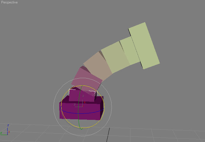

By default, the spine bends evenly along its length. As you rotate the tip hub, the spine interpolates the rotation throughout the spine nodes according to the curvature of the graph.
Default graph settings
The default curvature is evenly distributed among the spine bones.

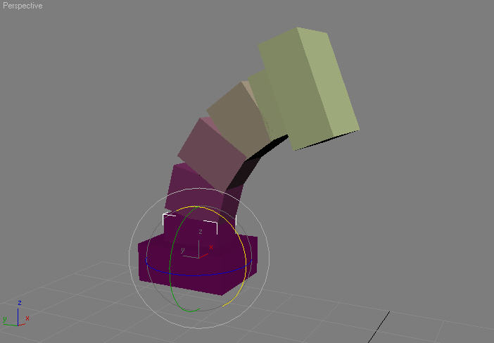

The following examples use a spine with the Absolute Relative value set to 1, meaning that it is a Relative spine.
If you adjust the graph to be flatter at the start and bend up sharply at the end, then the spine will also bend sharply at the end.

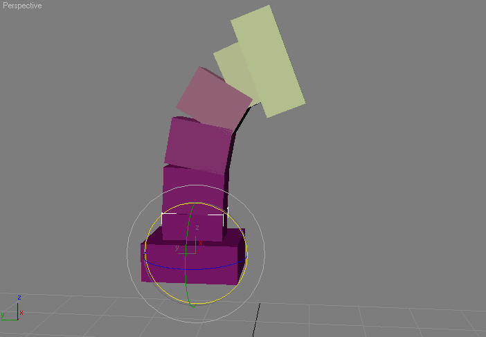

You can also configure the spine to bend more at its base.

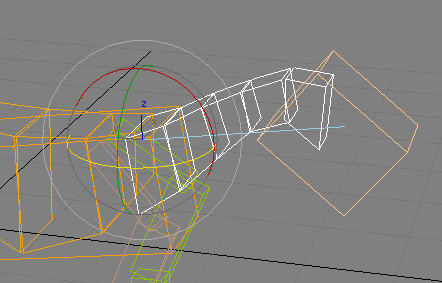

Spine Direction Vector
The Spine Direction vector is a line that determines the default direction for the spine. In other words, when the spine is at rest, it should project along this vector. By default, the Spine Direction vector points along the base hub’s length axis: Z for Z axis-aligned rigs and X for X-aligned rigs. See Understanding the Bone Length Axis.
You will get better results if you ensure that the blue line runs close to default curvature of the spine.
