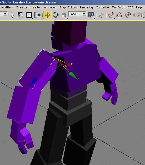

By default, CAT uses the X axis as the length axis for all bones. This means that if you select a bone and activate Move transform mode and set the coordinate system to Local, the axis designated as the length axis is aligned with the length of the bone.
Bone Length Axis set to X Axis
Setting the bone length axis

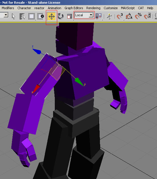

If you select the CATParent and go to the Modify panel you will find the Bone Length Axis group. If you change this setting from X to Z, you will see that your bones are now aligned to the Z axis.
Bone Length Axis set to Z Axis
