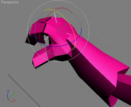

When Target Align is set to 0.0, the palm moves but does not rotate with the IK target; instead, it remains aligned with the last bone on the limb. On a humanoid character, that is the forearm.
Palm has not inherited IK target rotations.

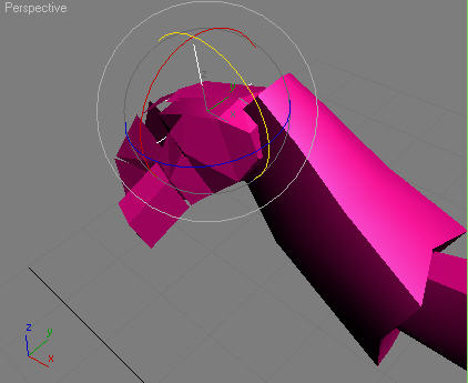

When the Target Align value is set to 1.0 the palm inherits both positions and rotations from the IK target.
Palm has inherited IK target rotations.
