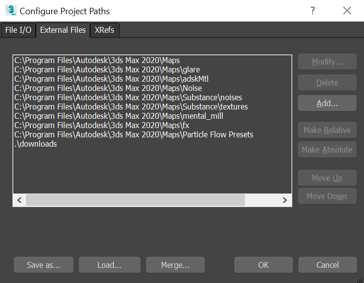

External Path Configuration
In this panel, you can add or modify path directories for bitmaps, DirectX effects (FX, CGFX, and XMSL files), and downloads using i-drop.
  • Default menu: Customize menu > Configure Project Paths > Configure Project Paths dialog > External Files panel
  • Alt menu: Customize menu > Customization > Configure Project Paths > Configure Project Paths dialog > External Files panel
Note: By default the paths for \Maps\fx, \Maps, and the root folder are all relative to the root directory of 3ds Max, whereas the \downloads folder is relative to the project folder by default.

To modify a file path:
  1. On the External Files panel, choose a path entry.
  2. Click Modify.
  3. In the Choose Directory dialog, do one of the following:
    • Enter a path in the Path field.
    • Navigate to locate a path.
  4. Click Use Path.
    The new path takes effect immediately.
To add a path for a file:
  1. On the External Files panel, click Add.
  2. On the Choose New Bitmap Path dialog, do one of the following:
  3. If you want to include subdirectories in this path, turn on Add Subpaths.
  4. Click Use Path.
To delete a path for a file:
  2. Click Delete.
    The path location is removed.
  3. Click Cancel to restore the path.
    This closes the Configure Path dialog without saving any path changes.
To move a path up or down in the list:
  2. Do one of the following:
    • Click Move Up to move the entry closer to the top of the list, giving it a higher priority in the search process.
    • Click Move Down to move the entry closer to the bottom of the list, giving it a lower priority in the search process.
