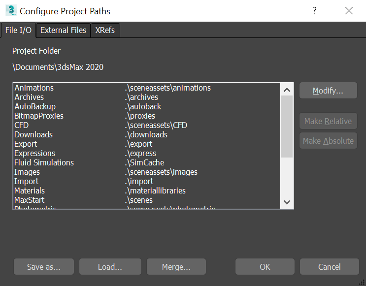

Procedures
To modify a file path:
- On the Configure Project Paths dialog, click the File I/O panel, and choose a path entry.
- Click Modify.
- In the Choose Directory dialog, do one of the following:
- Enter a path in the Path field.
- Navigate to locate a path.
- Optional step: Enter a description of the path in the Label field.
This description later appears in the path list.
- Click Use Path.
The new path takes effect immediately.
