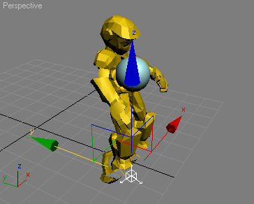

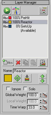

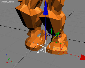

- In the Layer Manager list, select the layer to transform.
- Click
(Display Layer Transform Gizmo). The gizmo appears in the viewport at its default position: between the feet of the rig.
Note: The transform gizmo is not automatically selected when created, but is shown selected in the preceding illustration for better visibility.

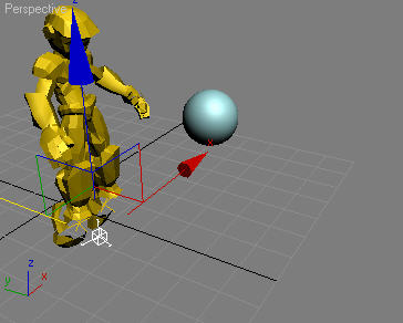

Select the transform gizmo and move it.
The rig and its entire animation move as well.

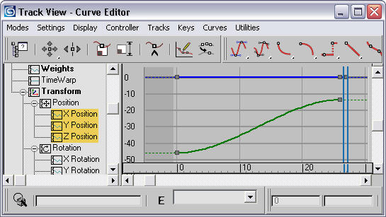

You’ll find the animation keys for the transform gizmo in the Curve Editor in the Transform branch, on the CATParent under the selected layer. You can also access the keys quickly with the Ranges View function.

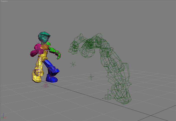

- Display Ghost
- After creating a transform gizmo, you can use it to display a ghost of the animation on a particular layer. This is particularly useful if you are blending between two different layers. The ghost can tell you which animation is being played back on a layer even if that layer is disabled, or whether your character is using a completely different animation on a separate layer.
