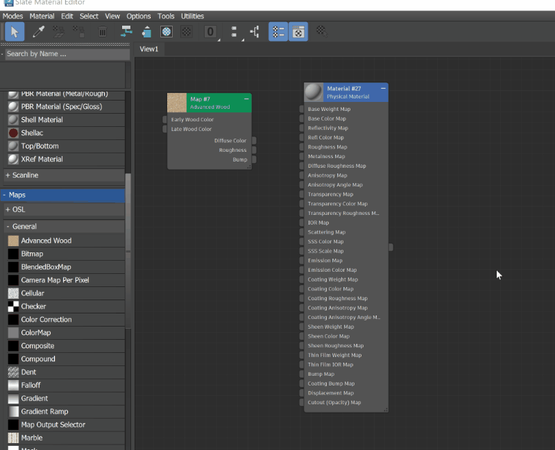

Create a compound
To create a compound in the active view:
  1. Select one or more nodes in a graph or within another editable compound.
  2. Open the right-click menu > Package Nodes in Compound.
The selected nodes are included in the new compound, and any existing connections become ports.
Screen recording GIF of someone creating a compound in the Slate Material Editor.
Creating a compound in the active view.

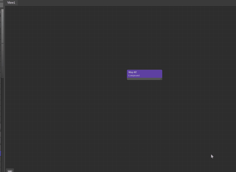

Promote attributes in a compound
To promote key attributes to the top level of a compound:
  1. Double-click a compound to enter it.
  2. Find the attribute port you want to promote.
  3. Drag out and let go of the connection line for the desired attribute port.
  4. Select Expose as Input/Output parameter.
Note: Input and Output ports can both be promoted to the top level of a compound.
To rename a promoted attribute, right-click the promoted attribute within the compound and select Rename.
Screenshot GIF of a user exposing an input in a compound.
Promoting an attribute in a compound.
