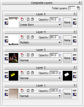

The controls for a Composite map include the list of the maps it combines along with a blend mode, opacity setting, and mask for each.

Composite Layers rollout
- Total Layers
The numeric field shows the number of map layers. To add a layer at the top of the stack of layers, click the
button.
Layer rollout
The Composite map uses a separate rollout for each layer’s controls, with as many rollouts as there are layers. Each layer rollout is titled with the optional name first, followed by “Layer” and then the layer number.
The layers are applied in order of increasing number; the layering in the material reflects the order of layers in the interface. Layer 1 is lowest; layer 2 is immediately above layer 1, and so on.
The map composites layers in the same order. Layer 2 modifies the output of Layer 1; Layer 3 modifies the output of Layer 2, and so on.

- Opacity
The relative transparency of the unmasked portions of the layer. At 100, the layer is completely opaque. As you lower the Opacity value, more of the underlying layers show through.
- [mask map]
To assign a mask map to the layer, click this button and then use the Material/Map Browser. The mask works the same as the Mask map: Black areas are transparent; white areas are opaque; and gray areas allow degrees of transparency. So, for example, if the layer is to be a decal, the decal image area would be white and the rest of the image map would be black, so underlying layers can show through.
After a mask map is assigned, the button image is a thumbnail of the map, and clicking it takes you to the parameters for the map.

- [blend mode]
Use the drop-down list to choose how the layer pixels interact with those in underlying layers. In the following descriptions, A refers to the current (front) layer and B refers to the result or output of underlying layers.
Note: Because Layer 1 has no underlying layers, its blend mode setting has no effect.- Normal Displays A without any blending. This is the default setting.
