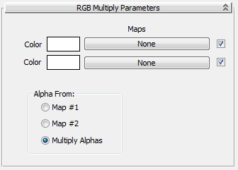

This map combines two maps by multiplying their RGB values. For each pixel, the red of one map is multiplied times the red of the second map, the blue times the blue, and the green times the green.
If the maps have Alpha channels, RGB Multiply can output either map's alpha channel or a new Alpha channel produced by multiplying the Alpha channel values of the two maps.
You can also make one of the maps a solid color, which tints the other map.
Interface
Color #1, Color #2
Click a map button to assign one of the maps. The checkbox toggles the map. To tint one of the maps, turn off the other map and click its color swatch to choose the tint color by using the Color Selector.
Alpha From group
This setting lets you determine how to generate alpha (transparency) for the map. If neither map has an Alpha channel, these options have no effect.
  • Map #1 Uses the first map's Alpha channel.
  • Map #2 Uses the second map's Alpha channel.
  • Multiply Alphas Generates a new Alpha channel by multiplying the Alpha channels of both maps.
