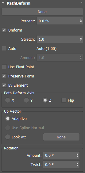

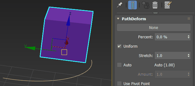

To use the PathDeform modifier, click the Pick Path button immediately after applying it, and then select a shape or curve consisting of a single open or closed spline. Once the object is assigned to the path, you can adjust the parameters to deform or animate the object along a gizmo copy of the path.
Interface
Path Deform rollout
- Pick Path button
Click to select a spline or NURBS curve to use as the path. The gizmo that appears is shaped like the path and is aligned with the local Z axis of the object. Once you assign the path, you can adjust the deformation of the object using the remaining controls in this rollout. The path may contain multiple curves.
The Pick Path button
Note: The Pick Path button appears in the rollout labelled as None and takes the name of the path once one is selected. - Percent
- Sets the percentage along the spline path that will be used as the start of object deformation.
- Uniform
- Bases the percent calculation on the actual spline distance rather than interpolated between knots.
- Stretch
- Sets how much to stretch the source object along the path.
- Auto
- Uses the indicated value to stretch the source object across the entire spline length.
- Amount
- Sets the amount to stretch.
- Use Pivot Point
- Uses the pivot point of the object as the deformation reference point.
- Preserve Form
- When enabled, makes the object follow the spline while maintaining its shape rather than conform.

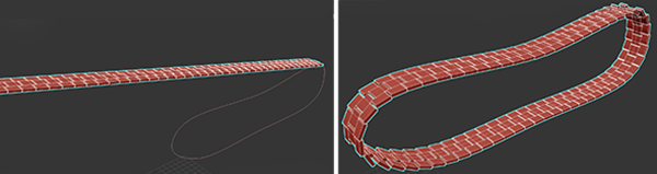

- By Element
- When enabled, deforms each mesh element on the model independently along the path. This option can help prevent a mesh with multiple elements from becoming deformed or distorted, for example when modeling tank treads.
By Element option enabled (right)
When enabled, the averaged center of the element is used to position the element on the path. When disabled, the pivot location of the mesh is used to position the object along the path.
Path Deform Axis group
- X
- Sets X as the deforming axis along the spline.
- Y
- Sets Y as the deforming axis along the spline.
- Z
- Sets Z as the deforming axis along the spline.
- Flip
- Reverses the gizmo path 180 degrees about the specified axis.

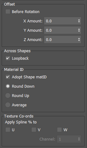

Offset group
- Before Rotation
- When enabled, applies the offset before performing rotation operations.
- X Amount
- Sets the offset value along the X axis.
- Y Amount
- Sets the offset value along the Y axis.
- Z Amount
Across Shapes group
- Loopback
- When enabled, makes the deformed object loop back to the beginning of the spline. When disabled, the deformed object continues along the direction of the first or last knot.
Material ID group
- Adopt Shape matID
- Makes the object adopt the material ID(s) of the underlying spline(s).
- Round Down
- In the case of multiple splines, takes the lowest value.
- Round Up
- In the case of multiple splines, takes the highest value.
- Average
- In the case of multiple splines, takes the average value of the highest and lowest, rounding down.
Texture Coordinates group
- Apply Spline % to
- Allows the overwriting of UVW coordinates based on the percentage along the path of an object's vertex. Click to select the desired coordinates to be overwritten.
- Channel
- Specifies the target UVW channel.

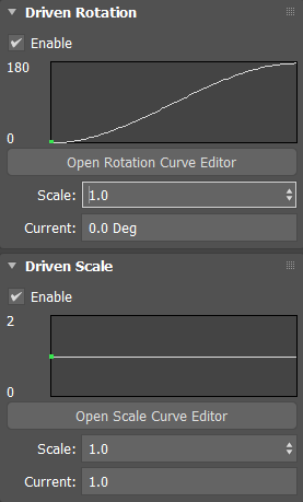

Driven Rotation and Scale rollouts
These features provide the ability to specify the rotation and scale of the deformed object along the spline's path.
The drawn curve represents the calculated value along the path of the driving spline. The 0% value will always equal 0 degrees of rotation/scale.
Driven Rotation rollout
- Enable
- Enables custom rotation along the spline.
- Open Rotation Curve Editor
- Opens the Rotation Curve editor where the curve can be edited using standard controls.
- Scale
- Multiplies all rotation values with the specified scale.
- Current
- Displays the current rotational angle for the deformed object along the spline. This field is not editable.
Driven Scale rollout
- Enable
- Enables custom scale along the spline.
- Open Scale Curve Editor
- Opens the Scale Curve editor where the curve can be edited using standard controls.
- Scale
- Multiplies all scale values.
- Current
- Displays the current scale for the deformed object along the spline. This field is not editable.
