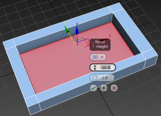

  6. Go to the Polygon sub-object level, select the inside polygon on the top of the box, and extrude it inward about 10 units. Exit Extrude mode.
    Note: 3ds Max provides various methods for achieving a result similar to this, but this one is particularly apt for examining the Chamfer modifier options.

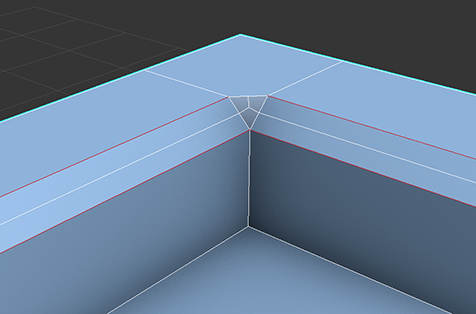

  6. Under Corner Options, set Mitering to Tri, which replicates the legacy Standard option of previous versions.
    Note that the polygons at the corners are now triangles. Triangular polygons can lead to unpredictable results when modeling, so it's better to work with quads whenever possible.

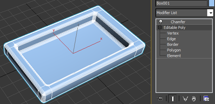

  8. Set Depth to 0.5 and increase Segments to 3.
    This produces a nicely rounded chamfer, with a smooth transition between the adjacent surfaces.

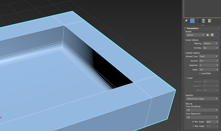

  5. Set Selection to Selected Face Edges.
    This applies the chamfering to all edges of the polygon selection on the stack, including the "inside" edges between adjacent selected polygons. This produces chamfering of the inner vertical edges.

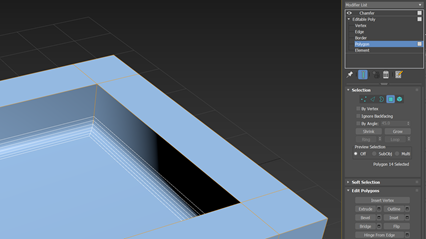

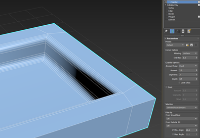

  6. Select Editable Poly again and click on the Polygon button.
  7. Turn off Show End Result () to better see your selection. Then select one of the inside walls of the box and hold Shift and click the face next to it. This will select the entire loop of faces.
  8. Go back to the Chamfer modifier and set Selection to Selected Faces Border.
    A border comprises only edges on the perimeter of each contiguous polygon selection. So with the Selected Faces Border option, interior edges such as the vertical corners are not chamfered.

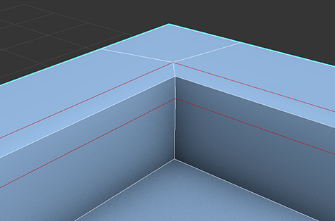

Part 4: Use Crease Weights to Drive Chamfering
  1. From the Chamfer Options group, set the Min Amount to 0 and the Max Amount to 1.
  2. In the stack, select Editable Poly and under Selection click Faces.
  3. Select the four top faces of the box.
  4. Hold Shift and under Selection click Edges to select the border edges of all the selected faces.
  5. From the Edge Properties group in the Edit Edges rollout, set the Crease Weight to 0.1.
  6. Repeat steps 4 and 5 to select the border edges underneath the box, and then repeat step 6 to set the Crease Weight to 1.
  7. Exit Edge mode and in the stack, click on Chamfer.
  8. From the Chamfer Options group, adjust the Min Amount and Max Amount to see the effect on the chamfering by the newly applied crease weights.
