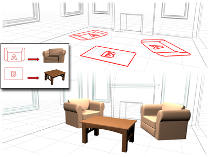

Typically, designers use two-dimensional shapes to represent objects, such as furniture, in their AutoCAD designs. However, when they link their DWG files into 3ds Max for visualization, they want to see how the objects will look in their design.

Top view of 2D symbols used to represent 3D objects
The Substitute modifier lets you quickly replace one or more objects with another in the viewports or at render time. The substitute object can be instanced from the current scene or can be referenced from an external file.
The Substitute modifier replaces the 2D objects with their 3D counterparts.
