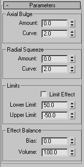

Parameters rollout
Axial Bulge group
These controls let you apply a bulge effect along the Squeeze gizmo's local Z axis, which is aligned by default with the object's local Z axis.
Amount
Controls the magnitude of the bulging effect. Higher values effectively elongate the object and cause the ends to curve outward.
Curve
Sets the degree of curvature on the bulging ends. You can use this to control whether the bulge is smooth or pointy.
Radial Squeeze group
These controls let you apply a squeeze effect around the Squeeze gizmo's local Z axis, which is aligned by default with the object's local Z axis.
Amount
Controls the magnitude of the squeezing action. Values larger than zero tend to constrict the "waist" of the object, and values less than zero tend to bulge the waistline out, as if the object had been stepped on.
Curve
Sets the degree of curvature into the squeeze. Low values cause a sharp squeezing effect, while high values create a gradual, less pronounced squeeze.
Limits group
These controls let you limit the squeeze effect's extents along the local Z axis.
Limit Effect
Limits the extent of the squeeze effect as defined by the Lower and Upper Limit settings.
Lower Limit
Sets the limit in the positive direction along the Z axis.
Upper Limit
Sets the limit in the negative direction along the Z axis.
Effect Balance group
Bias
Changes the relative amounts of bulge and squeeze while retaining a constant object volume.
Volume
Increases or decreases the effects of both Squeeze and Bulge in parallel.
