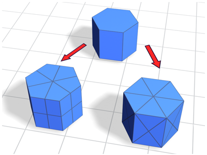

Top: Original mesh object
Lower left: Polygonal tessellation applied to edges
Lower right: Polygonal tessellation applied to polygon centers (Face-Center option)
