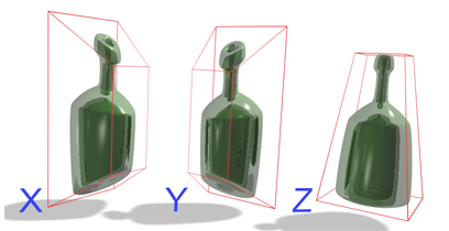

Examples of default tapers

The Taper modifier provides two sets of axes and a symmetry setting in the Taper Axis group box of the Parameters rollout. As with other modifiers, these axes refer to the Taper gizmo, not the object itself.

The central axis or spine of the taper: X, Y, or Z. Default=Z.
