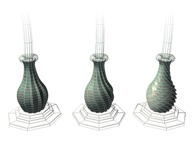

Left: Original model
Middle: A moderate twist
Right: An extreme twist
