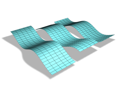

An object with the Wave modifier applied. Amplitude 1 and 2 can be changed, creating different profiles.

  2. Set one or both values for amplitude, or the vertical height of the wave in current units.
    Amplitude 1 produces a sine wave from one edge to the other, while Amplitude 2 creates a wave between the opposite edges. Switching a value from positive to negative reverses the position of peaks and troughs.
  3. Set the length of the wave and the distance in current units between crests of both waves.
    The greater the length, the smoother and more shallow the wave for a given amplitude.
