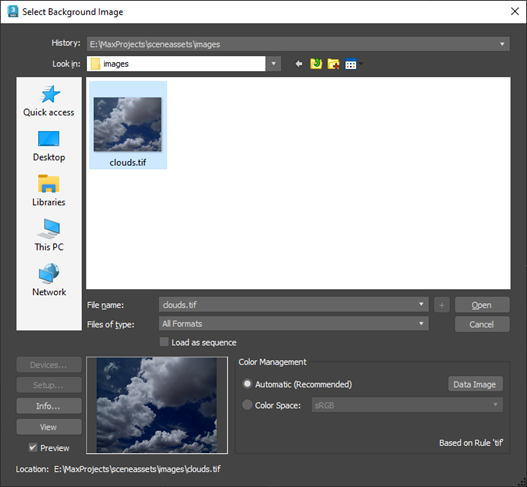

The Select Background Image dialog allows you to choose a file or sequence of files for a viewport background.
  • Scene menu > Configure Views > Viewport Background > Viewport Background > Viewport Background dialog > Background Source group > Files > Select Background Image dialog

To select a background image for a viewport:
  1. Activate the viewport where you want the image.
  2. Choose Views menu Viewport Background Viewport Background.
  3. Under Background Source in the dialog that displays, click Files.
  4. In the Look In field, navigate to the directory containing the file you want to use for the background.
    Note: The Select Background Image File dialog uses the last location where a bitmap was chosen, rather than the default bitmap path defined on the Configure User Paths dialog.
  5. Highlight the file name in the file list window.
  6. Click Open to select the image and close the dialog.
  7. Click OK to close the Viewport Background dialog and display the background image.

Interface
History
Displays a list of the most recent directories searched. Whenever an image is selected, the path used is added to the top of the history list as the most recently used path. The history information is saved in the 3dsmax.ini file.
Look in
Opens a navigation window to browse other directories or drives.
Go To Last Folder Visited
Click to return to the folder you previously browsed to.
Up One Level
Moves you up a level in the directory structure.
Create New Folder
Lets you create a new folder while in this dialog.
View Menu
Lets you choose the level of detail to display in the file list.
  • Thumbnails: Displays the contents of a directory as thumbnails, without the details.
  • Tiles: Displays the contents of a directory as large icons, without the details. If you widen the dialog, these tile across the width.
  • Small Icons: Displays the contents of a directory as small icons, tiled across the width, without the details.
  • List: Displays the contents of a directory without the details.
  • Details: Displays the contents of a directory with full details such as size and date.
[file list window]
Lists the contents of the directory, in the format specified by the View menu.
Tip: When View Menu Details is chosen, the contents of the directory are displayed with Name, Size, Type, Date Modified, and Attributes. You can sort based on each of these columns by clicking the column label.
File name
Displays the file name of the file selected in the list.
Files of type
Displays all the file types that can be displayed. This serves as a filter for the list.
Load as sequence
If there are more than one files that have the same root name and end in sequence numbers, turning Load as sequence creates an Image File List (IFL). Default=off.
Each time you choose an image, 3ds Max checks to see if an IFL sequence can be created. If the selected image does not yield a list, this option is unavailable.
You can use wild-card characters to filter image files. When Load as sequence is turned on, you can click Setup to configure the IFL file.
Open
Selects the highlighted file and closes the dialog.
Cancel
Cancels the selection and closes the dialog.

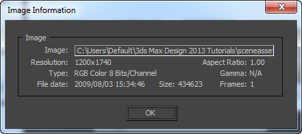

Info
Displays expanded information about the file, such as frame rate, compression quality, file size, and resolution. The information here depends on the type of information that is saved with the file type.
If the file has an embedded value, this dialog displays that value. Otherwise, it displays "N/A".
