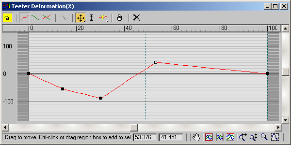

The Deformation dialogs for Scale, Twist, Teeter, Bevel, and Fit use the same basic layout.
  • Select a Loft object. > Modify panel > Deformations rollout > Scale, Twist, Teeter, Bevel, or Fit
The buttons in the window's toolbar and prompt area perform the following functions:
  • Change deformation curve display.
  • Edit control points (these can be animated).
  • Navigate the Deformation dialog.

Deformation grid
The area in the Deformation dialog that displays the deformation curves is called the deformation grid. This grid charts the value of the deformation along the length of the path.
These are the main grid components:
Active area
The light-colored area of the grid defines the first and last vertex boundaries of the path. The ends of the deformation curve lie on each boundary and cannot be moved off the boundary.

Deformation curves
You can see one or two curves in the Deformation dialog, based on the deformation type and the curve display setting. The curves are color-coded by axis.
A red curve displays deformation along the shape's local X axis. A green curve displays deformation along the shape's local Y axis.
