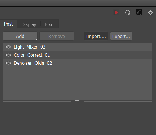

Imagers automatically sorted in a logical order: When you add imagers, they are automatically applied in the most useful order (for example, Light Mixers go first in the list). You can still re-order them manually if necessary. (MAXTOA-1304)

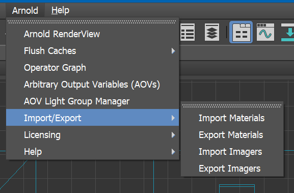

Imager setups can be exported and imported: A set of imagers can be exported to and imported from arnold files (.ass, usd), for exchange between scenes or to use as presets. (MAXTOA-1647)

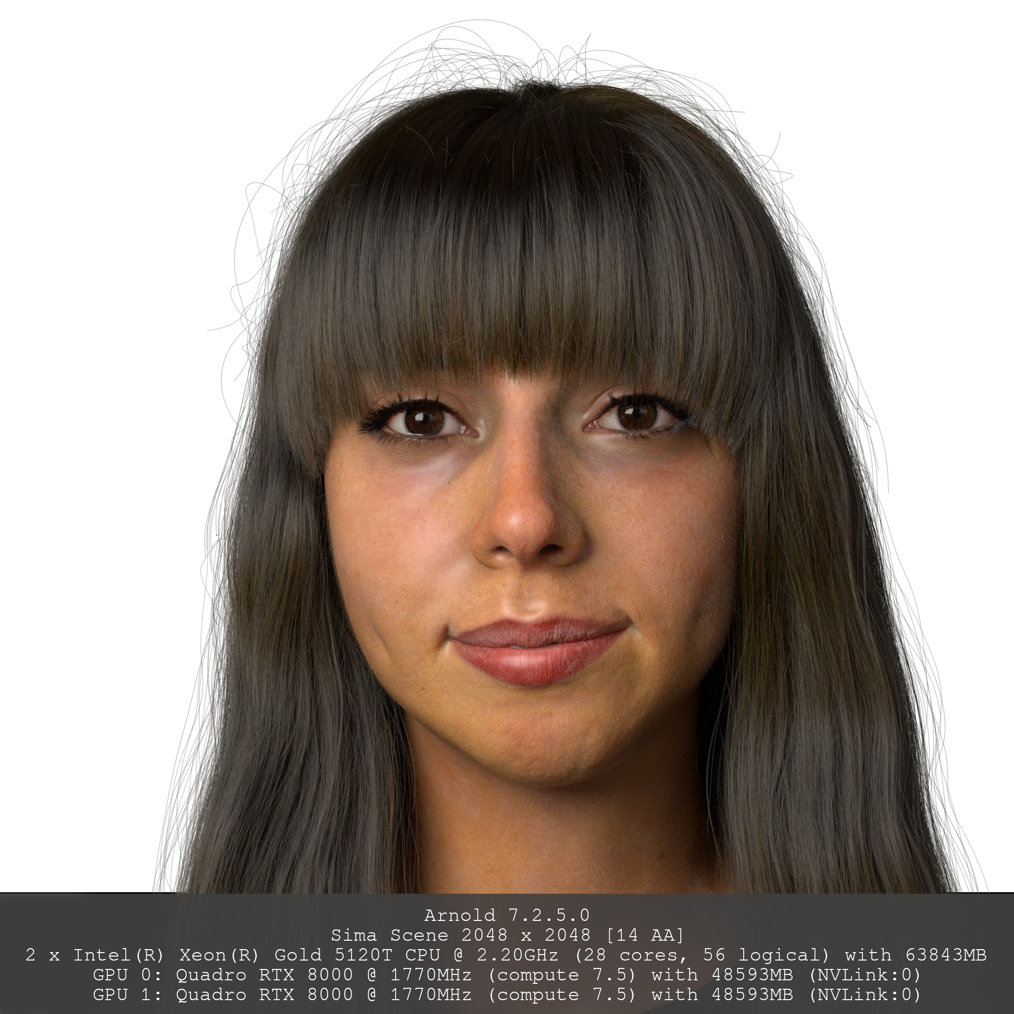

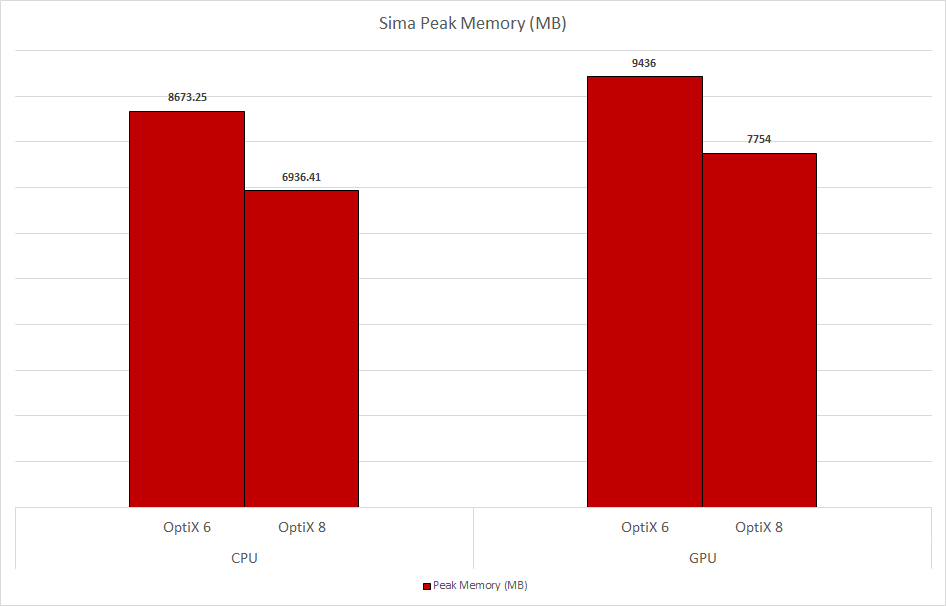

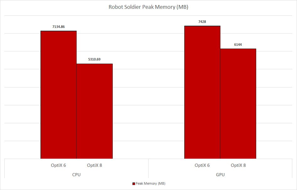

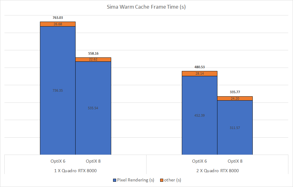

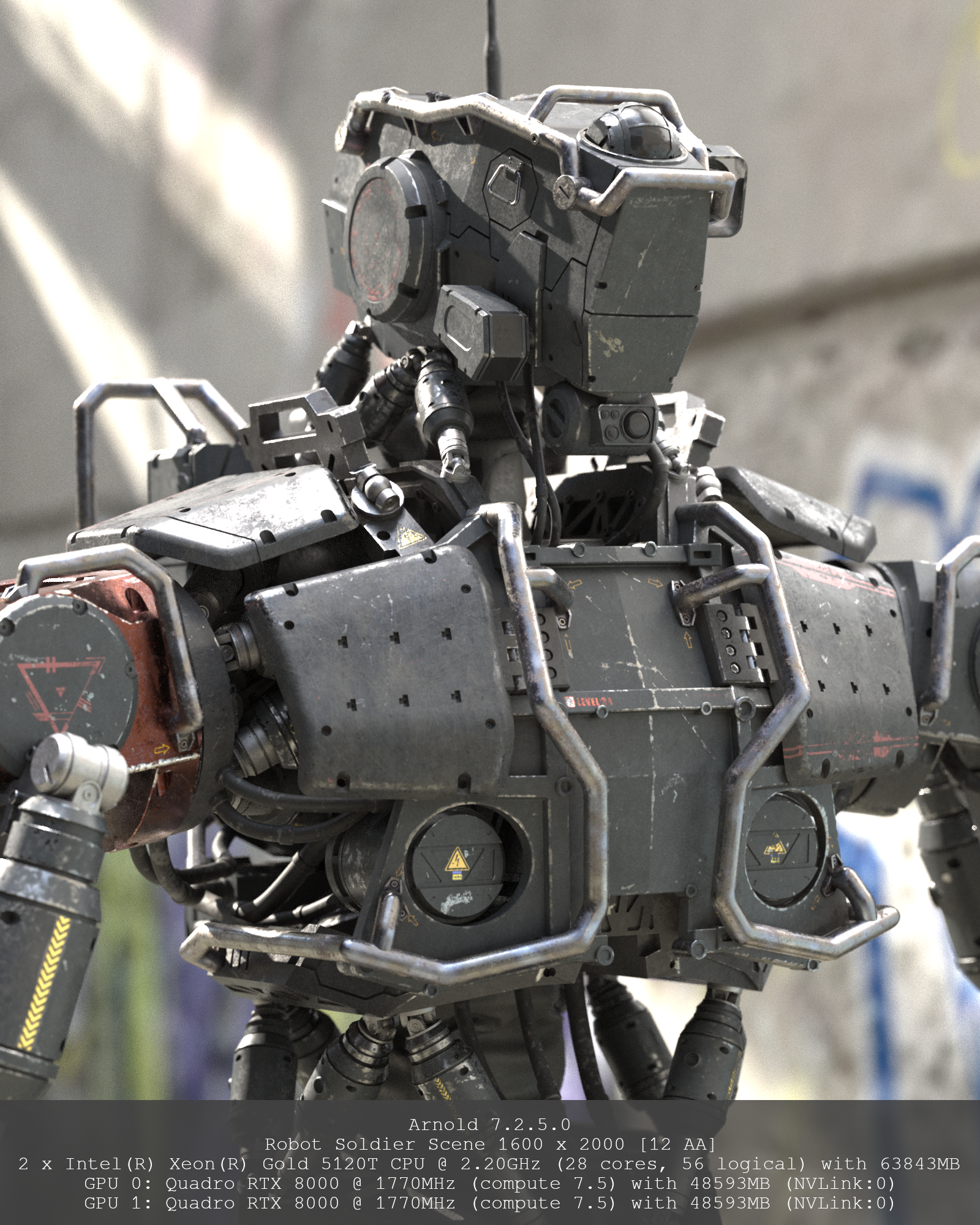

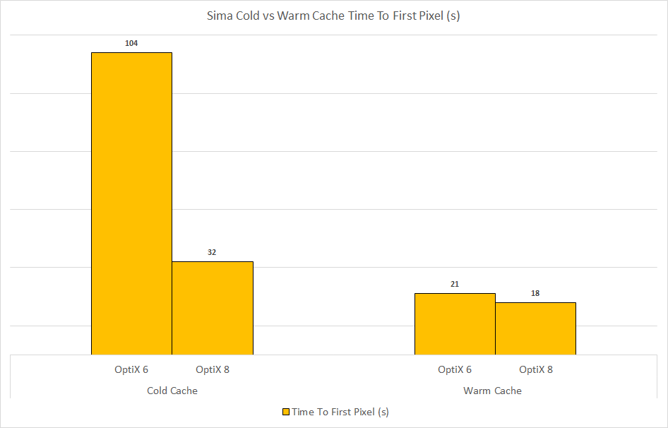

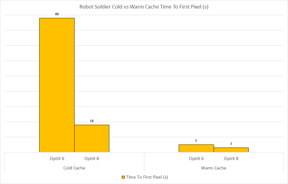

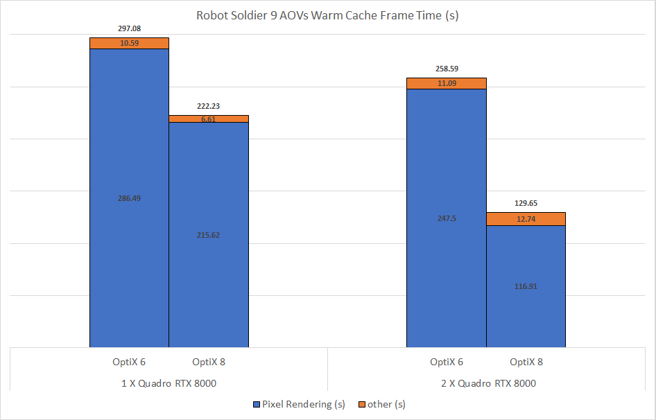

GPU renderer overhaul: A large part of the GPU renderer was rewritten using NVIDIA OptiX 8. This allowed numerous improvements such as much faster startup times, lower GPU memory usage, better scaling on multiple GPUs, and faster renders overall. (ARNOLD-9882)

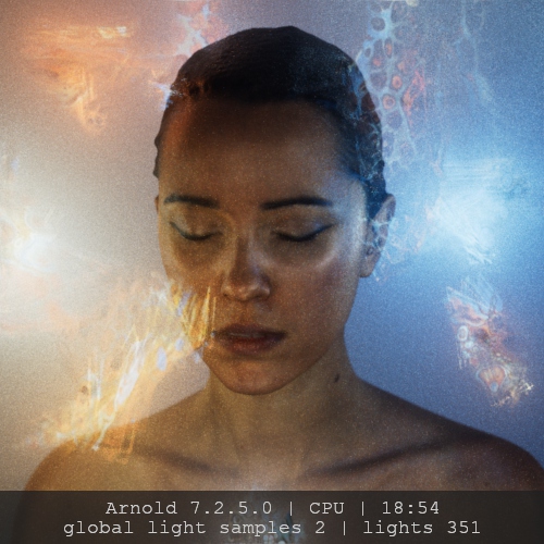

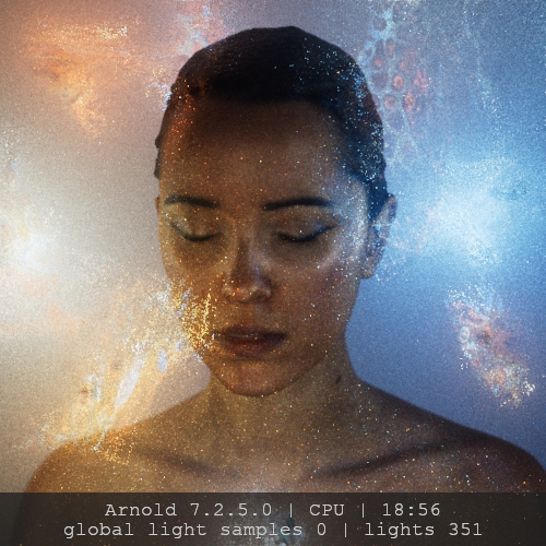

- Global light sampling in volumes: Global light sampling is now supported in volumes. The render time speedup when using global light sampling in volumes depend on the number of lights, but even scenes with only a few lights are faster to render. (ARNOLD-13095)
Below is an equal time render comparison of a scene containing 351 motion blurred mesh lights inside an atmosphere_volume.
| With GLS | Without GLS |

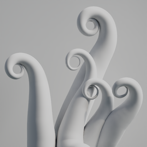

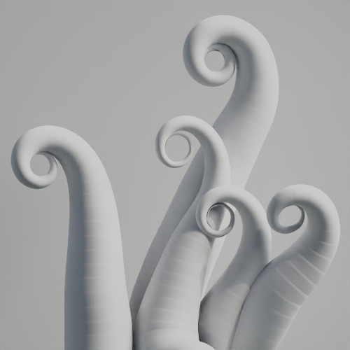

- Improved thick curves intersector: Curves in thick mode are on average 10% faster (in some cases, more than 100% faster) and they look better in closeups. (ARNOLD-2875, ARNOLD-8549 and ARNOLD-14391)
| 7.2.4 | 7.2.5 |

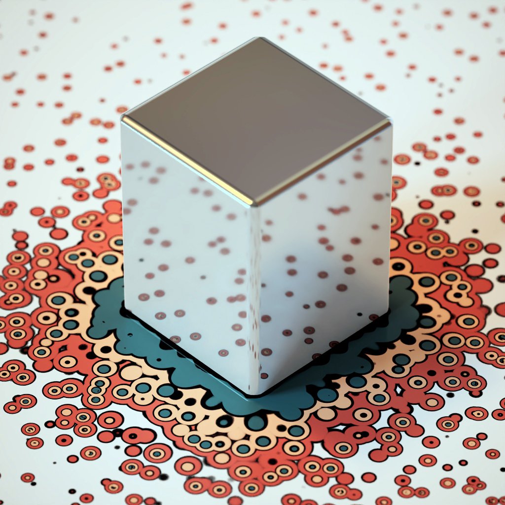

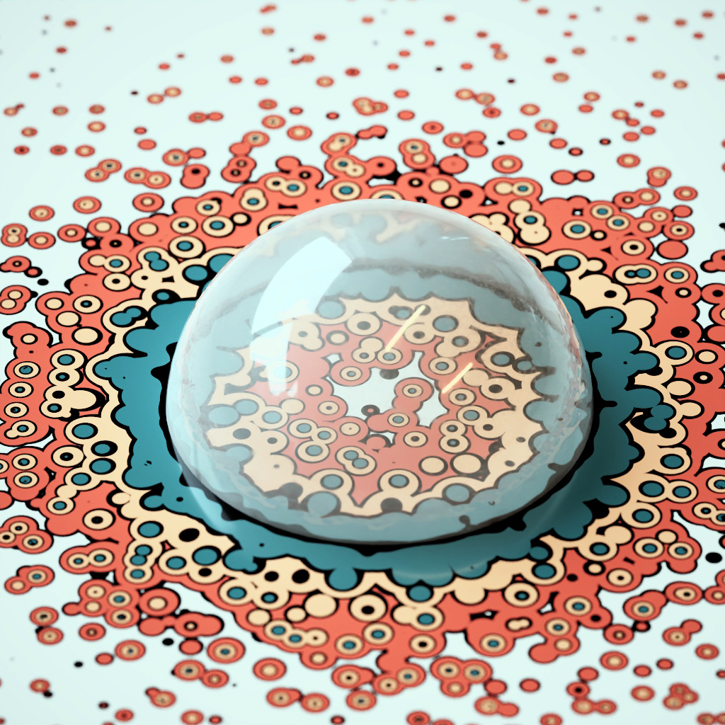

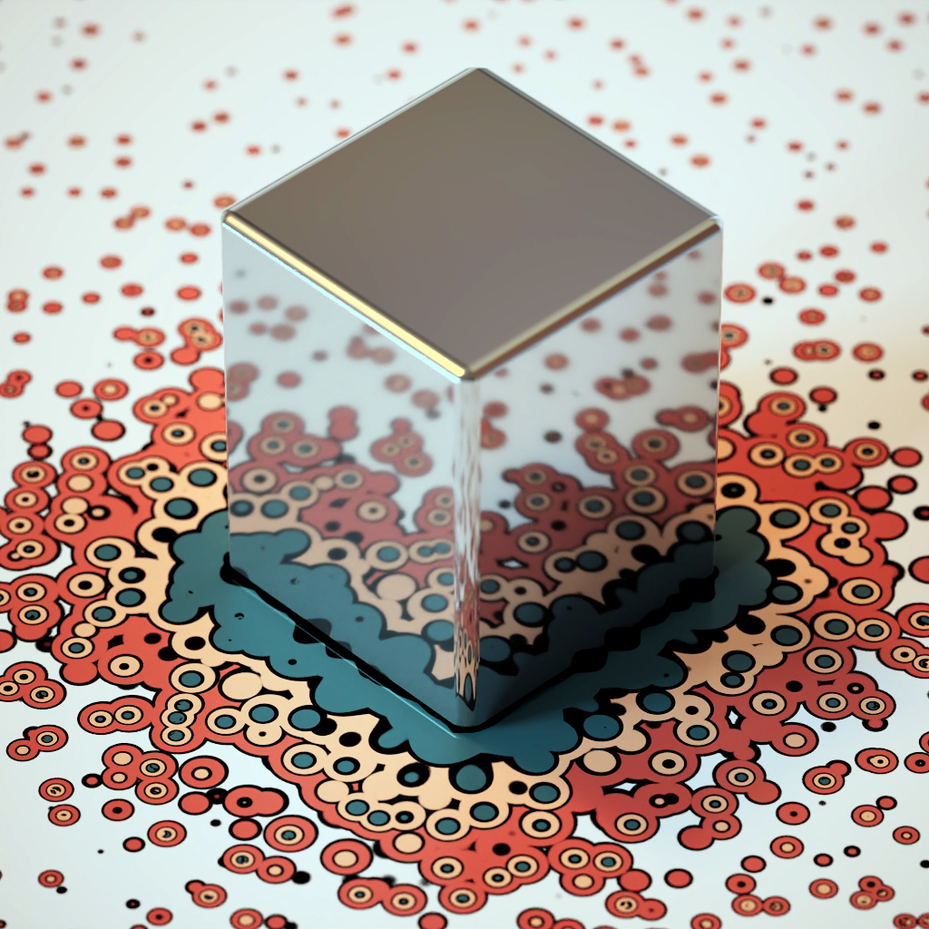

- Distance shader in reflections: The distance shader now properly handles secondary paths such as reflections. (ARNOLD-13883)
| 7.2.4 | 7.2.5 |
| 7.2.4 | 7.2.5 |

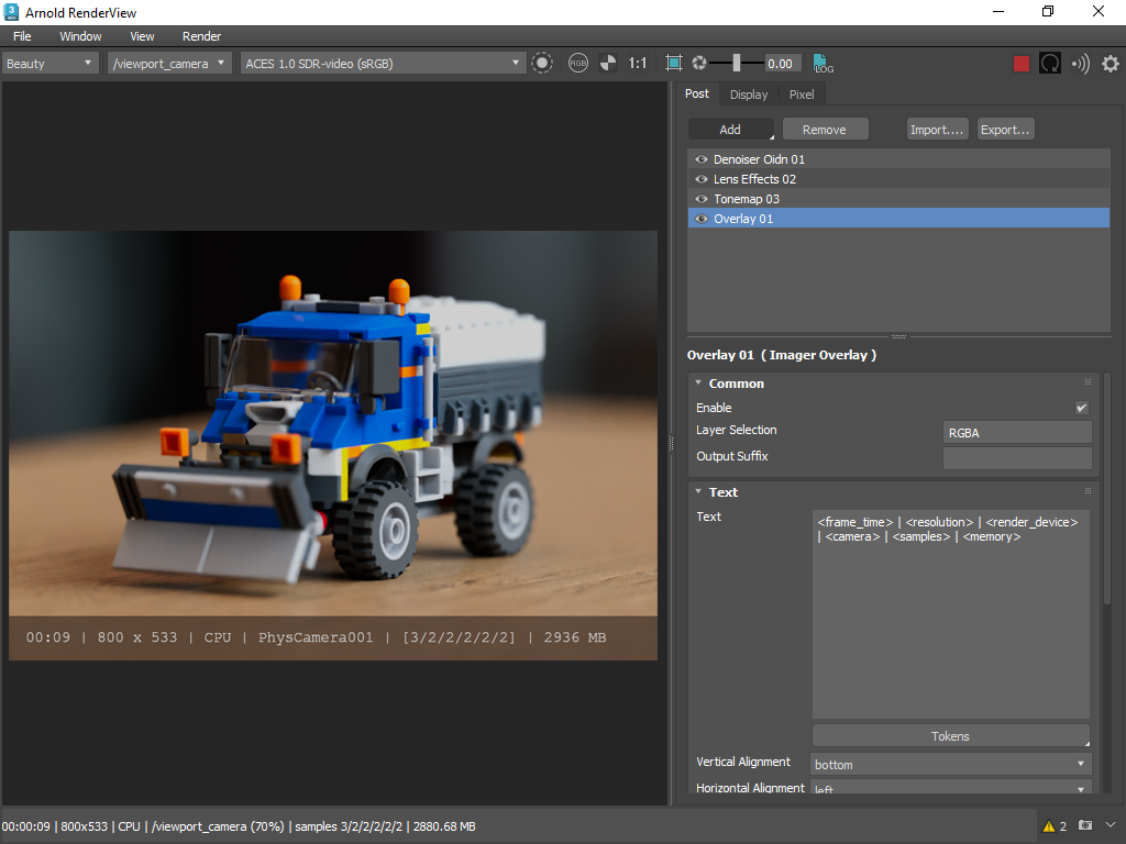

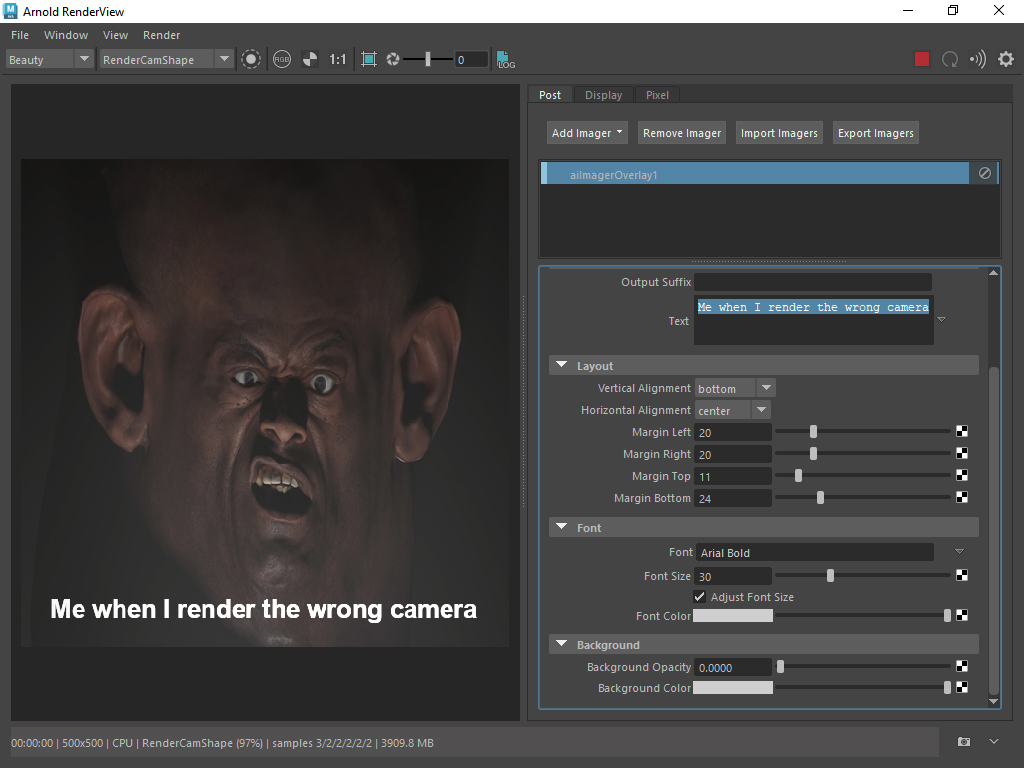

- Overlay imager: A new imager that allows you to decorate or tag your renders by printing text over the rendered images. Overlay text can use any of the system fonts (TrueType or PostScript), or custom fonts defined via the
OPENIMAGEIO_FONTSenvironment variable. You can include scene and system information, and render statistics, with pre-defined tokens, such as<frame_time>,<samples>, and<camera>. See the Overlay Imager documentation for the full list of tokens. (ARNOLD-14188)
| Overlay imager used to add text to the rendered image | Using tokens with an overlay imager |
