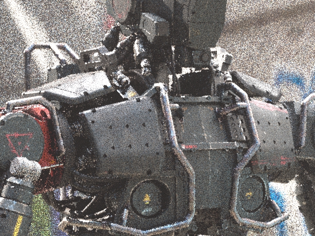

Progressive dithered sampling: Arnold now supports dithered samples in progressive and adaptive rendering. Dithering brings nicer noise distributions at low AA sample counts. (ARNOLD-10739)
| before 7.3.0.0, AA=1 | 7.3.0.0, AA=1 |
